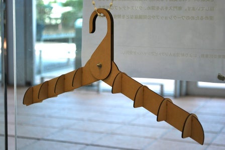

This hanger is made by using a Laser Cutter at f.Labo in japan.
MDF t=2.5mm (400mm×300mm) : 1
Screw (M4×15mm) : 1
Circular washer : 2
Ball head lock nut (M4) : 1

1. Cut (Red line is cutting)
2. Assemble
Please refer to how to make hanger.pdf when you assemble it.
