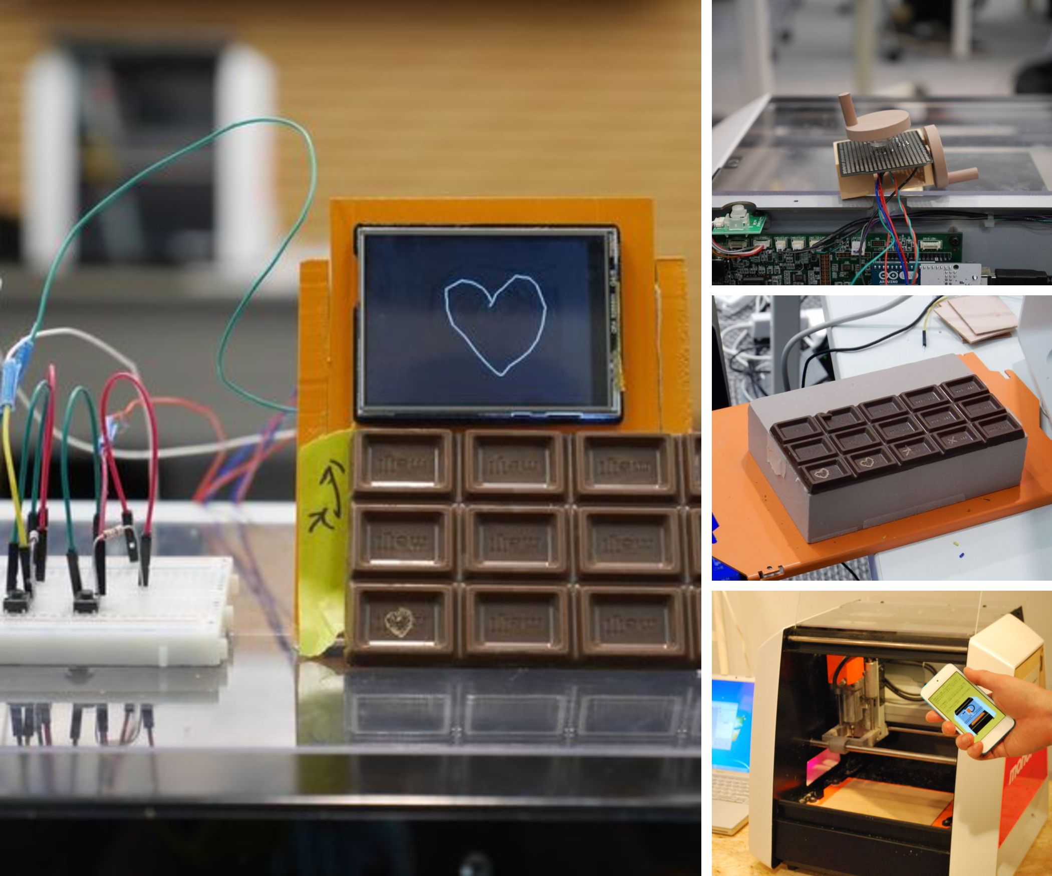

The SRM-20 is one of the "monoFab" series products, a machining tool, launched by Roland DG Corporation in September 2014. It is equipped with a slot that can mount a board for the open source hardware "Arduino", and, using the manufacturer's provided library, its functions can be easily expanded.
Step 1: Insert an Arduino Uno Board and Add a Beacon Module

- Turn on the SRM-20
- Open the cover of the SRM-20
- The app will notify of the action
- Close the cover
