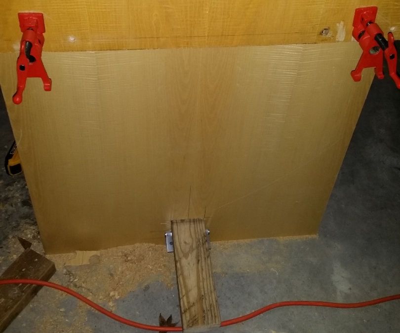

Now it's time to put some things together. I figured 5/16 lag bolts would work well enough, so I put my two leg pieces together, made sure my joints were properly spaced, and went to town predrilling and lag bolting these suckers together. I wanted the bolt pattern to look intentional, so I laid them out in some sort of symmetry. 9 bolts. Rinse and repeat for the other leg.

These legs were quite heavy by themselves, so working with them was... fun. I had a plan that seemed all well and good... and well, I ended up having to figure something else out real quick.
My hindsight shall be your insight. Definitely predrill and countersink your leg holes before you start. I tacked a 2x4 on each side of the top at an angle and figured I'd finagle the legs square and tack them temporarily while I bolt them together. bolt through the legs into the shorter top, and through the shorter top down through the legs. Make sure you keep in mind your spacing of bolts so you dont try and drill though where you already have a bolt.
It *mostly* worked. I smeared all the joints with liquid nails before slapping them together to close any gaps from the doors being uneven, and then smeared them again. Basically, just get the shorter top bolted between the legs any safe way you can. Then, have fun flipping her right side up :D
