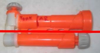

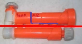

get your screwdriver and unscrew the four screws on the side of the gun and open it up. the insides should look like this. (sorry about the red line, i had to get this picture off of nerfhaven.com) edit: pictures are from gengar003 on nerfhaven
Step 2: Sawing Off the Old Barrel
now get your saw and saw off the old barrel at the blue line on the picture, and also try to leave as much of the strip of plastic inbetween the barrel and the pump as you can to support the new barrel you are going to put on.

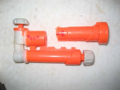

Step 3: Removing Air Restrictor and Sanding
the air restrictor should've came out when you sawed off the barrel (its technically not an air restrictor but im just gonna call it that), but if it didnt you can either break it off or cut it off with a knife or something (be careful not to touch the black rubber inside the gun) and then you can sand where the old barrel was so that it is flat. (the picture is of how the gun should look now, and thanx again to nerfhaven.com and gengar003 for the picture)
