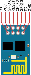

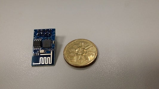

0. ESP8266 aka ESP-01. This one is manufactured by SEEEDstudio. It runs off 3.3v only; can be powered off arduino's 3.3v pin or a separate supply with 3.3v and 500mA. Do not plug a 5V source to it.

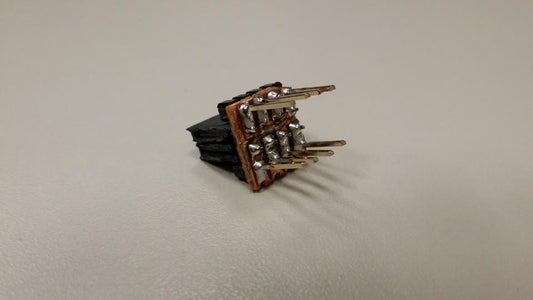

1. break out board for ESP8266. This is made of a 4x4 veroboard, PCB headers, and jumper header. Be sure to score a line to separate the copper strips from shorting the adjacent pins.

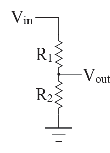

option B: use a voltage divider circuit to divide 5v source from Arduino to 3.3v source for ESP8266. Acceptable methods, definitely much better that plugging in directly.
URL for voltage divider calculation: https://www.abelectronics.co.uk/tools/resistor-vo... ; Vin is 5v, Vout is 3.3v (ish), enter either R1 or R2 with a resistor value available at your disposal.
The following diagram describes the setup with a 330ohm and 180 ohm resistors (the only 2 resistors available on hand at the time of making) voltage divider circuit

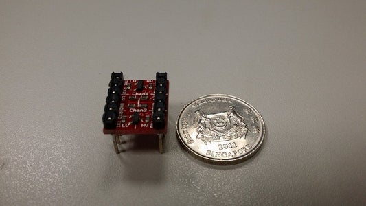

option C: logic level shifter, e.g those sold by sparkfun. This method is highly recommended

Rule of thumb: always check pin out diagram before wiring, ensure common ground, vcc and gnd are connected according to voltage specs. ESP8266 CH_PD aka chip power down and RESET are connected to 3.3V for logic high; TX & RX pair for comms: ESP TX-> Arduino RX; ESP RX-> Arduino TX
Assuming using Arduino Mega Serial2 (pin #16 and #17), ESP8266, and logic level shifter by sparksfun.
logical wiring schematic
MEGA ------sparkfun logic shifter -------------ESP 8266
5V -------------HV
3.3V-----------LV
3.3V-------------------------------------------------------VCC, CH_PD,RESET
GND----------GND (both HV and LV)---------------GND
TX(#16) ------HV chn0 RX==LV chn0 RX---------RX
RX (#17) -----HV chn0 TX===chn0 TX--------------TX
