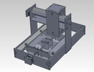

Step 1: The Mechanics
First image is the assembly view of the C i C in Solidworks (z-axis and train are yet to be modeled!)

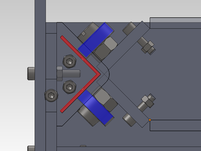

Next picture: close up of the frame; using widely available (skateboard) bearings (blue) and aluminium corner profiles (red). This rail system ensures smooth movement of the trains and no movements in other directions other then the rail.
Last picture shows M8 thread with a skateboard bearing which happens to fit nicely! (Both are cheap and compatible!)
