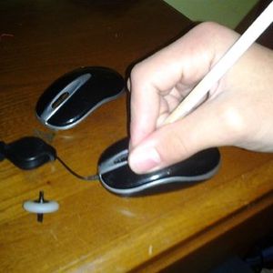

I had a mouse where the usb cord had broken so I used it to test the angle of the pencil

So the first thing is to open the mouse up and take out the scroll wheel
test the pencil in the space where the scroll wheel had been and make sure it will fit.
if you can pick up the whole piece by the pencil than you can move onto step 2.
if the pencil did not fit use a knife and cut a little bit off of each side and try again, keep doing that until it fits.

as I have already mentioned, I had a secondary mouse that was broken to test with.
I cut the pencil so that it rested in such a way as to let me still click on the left mouse button,
you will most likely need to experiment to find the right spot for you.
Step 4: Putting It All Together and Any Extras
Okey so now you put all the working parts together and voila! you now have your own optical pen mouse
