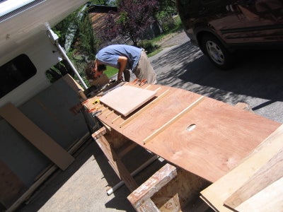

Step 1: Make a Big Table
Make a table of all of your bulkhead dimensions. No, really, do it. It's worth the time. Then cut out the deck, and glue on some blocks of wood to hold up the bulkheads, added in step 2. In the picture, the centerboard is sitting on top of the square pieces that will be used to join the bulkheads to the deck. The bottom of the hull only takes a very diffuse load, while the top of the deck has to take point loads (your feet). This means the top should be thicks, and thus that it makes a better spine on which to build a keel-less boat.

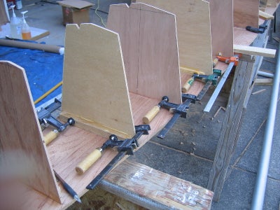

Step 2: Glue Bulkheads to the Deck
Cut all of your planks and glue your bulkheads to the bottom of the deck. It is helpful if you cut out any holes you need in the deck (say, for the mast and centerboard), before doing this. Make very sure that the bulkheads are centered along the axis of the boat. It wouldn't do to have a wobbly side on your boat. Also make sure that your bulkheads are cut and sanded to within about a millimeter of your design spec. This comes in handy later in decreasing the amount of time you have to spend making things fit when they do not. If you complete this step with great care, everything else will just fit.
