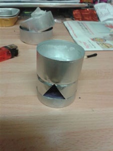

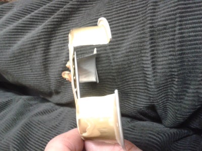

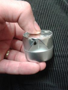

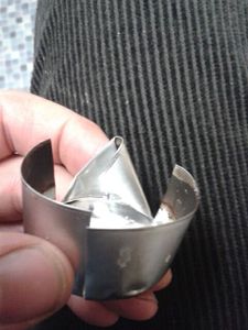

the vapouriser and support were made from the foil casings of two 8 hour tea lights these are 38mm diameter by 22mm deep. The vapouriser was used unmodified. The support made by cutting 3 evenly spaced slits in the side of the case then folding in the edges to form roughly triangular legs
Step 3: Test

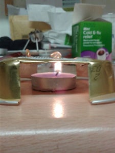

the legs of the support were place between the fuel pellet and foil container of the lower tea light that is used as heat source to cause vaporisation. The tea light was lit and checked that it remained burning (I've had problems previously when using tea lights as small burners getting air supply and exhaust paths)
the second foil casing was placed on the stand and a small amount of wax added about 2g (the residue not burnt by the wicks from 3 burnt out tea lights that was going to be otherwise reused).
Once the wax was molten attempts were made to light the vapour. This only proved successful once vapour was actually visible and required the use of a long match that actually had to touch the surface of the molten wax and act as a temporary wick. combustion was sustainable without this wick after just a few seconds.

Step 5: Improved Support

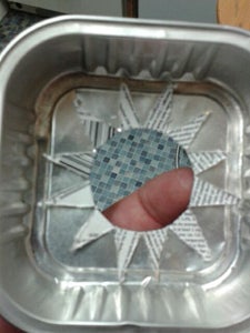

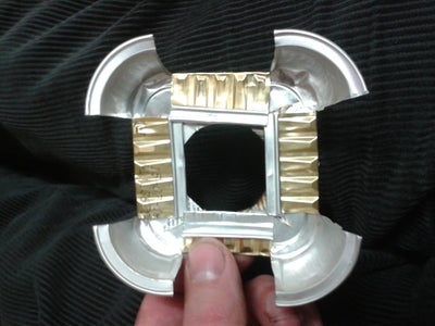

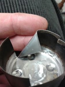

a sort through the recycling bag came up with some small foil trays that once contained cat food . These looked to be the right hight for the burner support. I cut a hole in the center of the base slightly smaller than the foil casing I was using for the burner. This means the support is not getting directly heated so more of the heat from the tea light goes to vapourising the wax.
The sides were cut down to the base just after the radius of the corners and the resulting flaps folded in. This gives a much better air flow around the tea light.

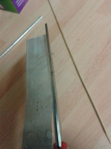

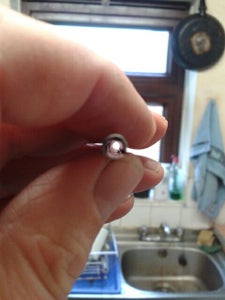

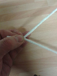

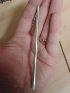

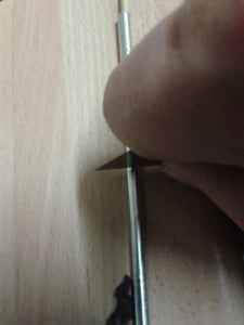

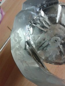

I made my air tubes by rolling strips of heavy foil (salvaged from another foil tray) around a bamboo kebab skewer. They were cut to length whilst still on the skewer using a Stanley blade(I must get around to making a back for a Stanley blade as I often use them like this and I'll end up cutting myself if I don't). To avoid collapsing the tube whilst bending to shape I twisted two pipe cleaners together and put this in the bore while I bent them. This wasn't 100% successful but it worked adequately.

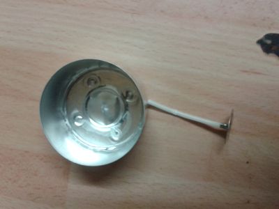

Step 7: The Improved Vapouriser

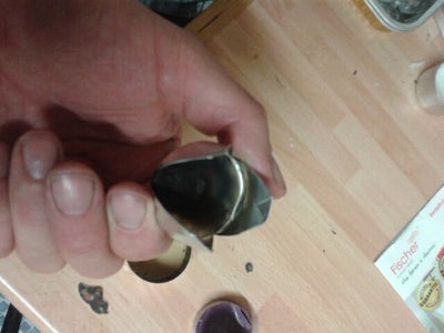

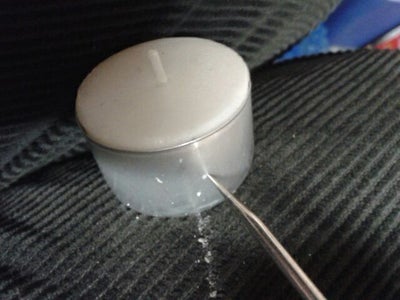

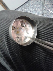

with a wax pellet still in place I pierced 4 evenly spaced holes halfway up the container. The wax was removed (with the tea lights I'm using the foil container wax pellet and wick are 3 distinct units and are clearly not made by pouring molten wax into the foil container) The holes were enlarged with a biro, the air tubes inserted and the foil of the casing moulded back around them. I used the scribe and the point of the skewer. I couldn't get the fit tight enough to do without glue. I cleaned around the tubes with a cotton bud wetted with lighter fuel (white petrol for zipo lighters) and applied a small amount of 2 pack quick set epoxy resin glue to each joint. In hindsight I should probably have left it overnight to fully cure rather than just letting it set before testing.

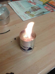

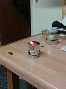

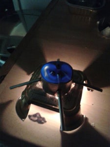

as on the previous test a small amount of wax was placed in the vapouriser and the lower tea light lit once vaporisation was occurring the vapour was ignited as before. The pictures are taken without room lights as the Blue flame achieved was not overly visible with them on. (The burn mark on the work surface is not connected to the current instructable.)

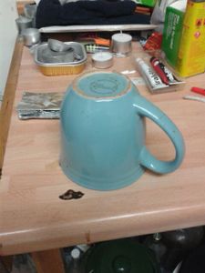

there are three ways to put out a fire. remove the fuel. remove the heat or remove the oxygen. I would have liked to have removed the fuel just by letting it burn out but failing to let the glue cure fully resulted in complaints about the smell. I had a wet tea towel on hand in the sink as a precaution (removal of heat and oxygen) note burn mark on work top from previous experiment. but opted for just removal of oxygen by using an oversized coffee mug. The flame suffocates and by leaving in place until cool most of the smoke/ vapour is contained and the equipment remains undamaged.
