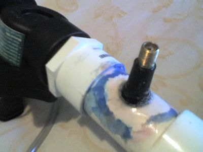

-schrader valve (car tyre valve)
- a bit of brass (u will need to thread this and drill through the middle) see pictures.

Dont forget to put in the schrader valve as well.
Now tape up the tubes, i used a roll of electrical tape.

    13 years ago on Step 2
    and where is the schrader vavle?
    0
    Johnthan
    Johnthan
    Reply 13 years ago on Step 2
    I would guess the black peace with the hose coming out of it.
    0
    Loveofchaos
    Loveofchaos
    Reply 12 years ago on Introduction
    Sorry buddy, schrader valve is the valve used to full the pressure chamber with air, generally people get them from old bike inner-tubes
