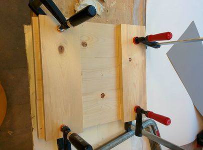

the cheapest way to create a lightweight wooden seat is by buying 1 long peace of wood, Cutting it to the right size and laminating it together. This proces is extremely simple and only requires some basic tools.
What we will need are:
- All the bar clamps you have.
- A saw.
- Wood glue.
first cut pieces as long as the height of your backpack. the amount of pieces will vary depending on the width of your backpack and the width of your plank.
Then cut 2 pieces the width of all the previous cut planks combined.
Now glue them together like in the picture. make sure to fasten your bar clamps tight to squeeze the glue out. After its assembled let it dry for a while.
When its dry draw your backpack's shape on the side of your board that's facing downwards in the picture,and cut it out using a bandsaw or a jigsaw. Then sand it till its smooth. Finally drill a hole in every corner. make sure they are at least an inch away from all sides but far enough out to have a stable swing. The hole diameter is the rope diameter +2 mm.
