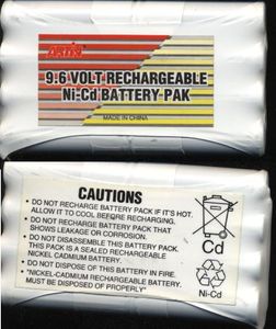

- an accu (9 V battery wil also work)

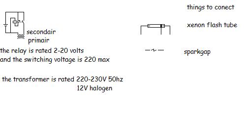

i have made a scematic on my work if you want use it.
my scematic isnt corect becaus i mesed up one contackt whit the flashes.
the weir 3 conectet things in the botten is a camera flash
and the weird thing whit some switches and coildata is the relay
the 2 coils is the transformator
1. conect the other end of the coil to a switch
2. conect one end of the coil and to the other end of the switch see picture
3. do a test run if the relay is making a buzzing noise than youre oke
4. put wires to the transformater "primary coil" warning this is the part were the sparks wile come out.
5. put wires in the relay so it wil be turned on and off when it is on
6. put 2 wires together one to the coil and the other to the wire out step 5 and conect it to the battery.
7. put the other wire out of step 5 on a contact to the transformator "secondairi coil"
8. put a wire betwean the oteer conection of the transformator and the relay coil (not the wire to the battery
9. put one wire to the wire out of step 8 and the battery dont conect it
you can get a non deadly shock out of the primary coil

Step 5: Let the Flash Spark
there are 4 ways to conect a flash light
but you can do 6 things whit my device.
if you connect the outer ends of the flash you get a wireling spark.
if you connect the middele end and a end far away from that you get a blue light.
but if you conect the last wire to the tube itself the spark wil be wirling.
if you conect the middele end to and the end closest to it together at one end of the transformer and the other end of the tube to the other end of the transformater you get a spark that is strait.
you can make sparkt whit is around 2 mm.
you can power smal devices whit it.
this device makes around 100-200 volts ac.
