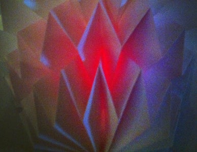

A pop up with an RGB LED behind it. Attach the battery to make it light up.

start folding along the crease lines. It is best to first pre-fold all the lines one by one until the paper is soft and flexible. Then try to get the whole piece into its shape.
