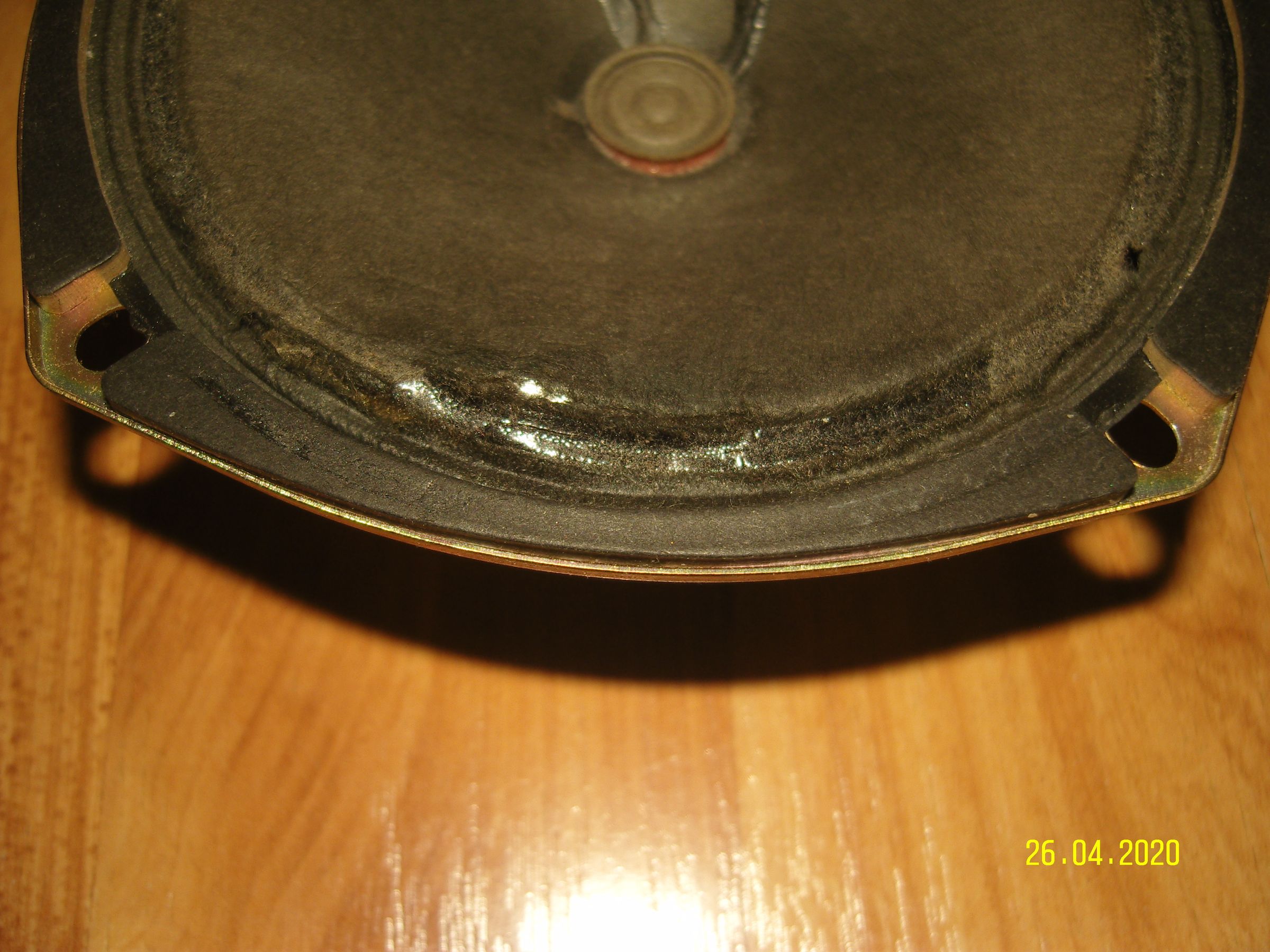

Step 1: Is It Really to Trash?
As you noticed from the first image the speakers appeared in a very bad situation. Actually you wouldn't tell, but this is an ordinary situation for a 20 years old woofer, indeed the edges (made of foam or rubber), after many years crumble. The tweeter's cone doesn't need to move as much as the woofers so there is no edge which could break. A speaker in this state usually emits a very low sound, and it's practically useless, many people throw it away, since a refurbishing professional service could be expensive. I will explain how to bring them back to life with a 15$ investment.
