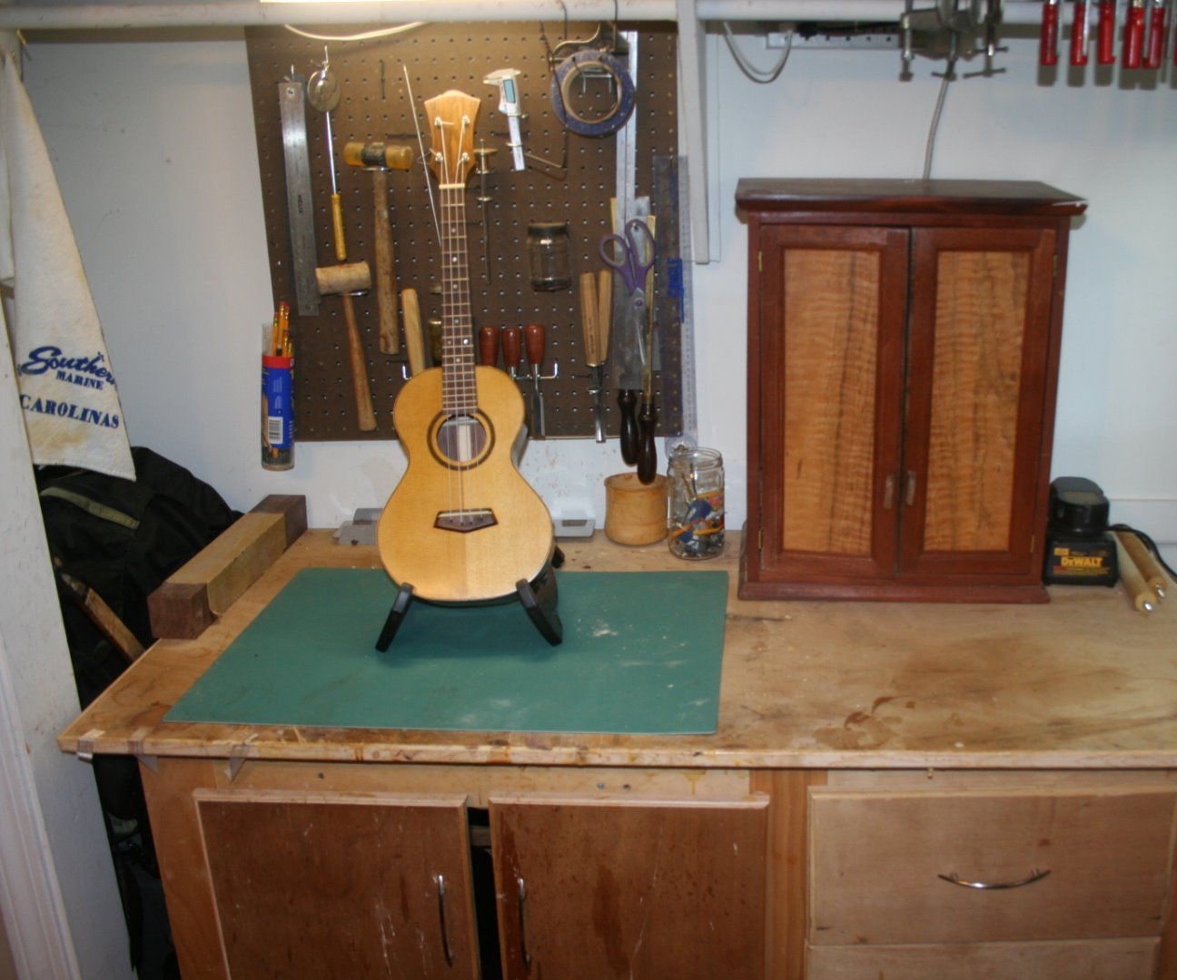

Step 15: Putting It Together
After bolting the neck on I glued the bridge on and set up with a bone nut and saddle strings,tuners and a little tinkering its ready to go. I love the way it sounds and plays This is my 5th ukulele build this on turned out great ill try to put a video up soon.Thanks for viewing Ricky Sp8
