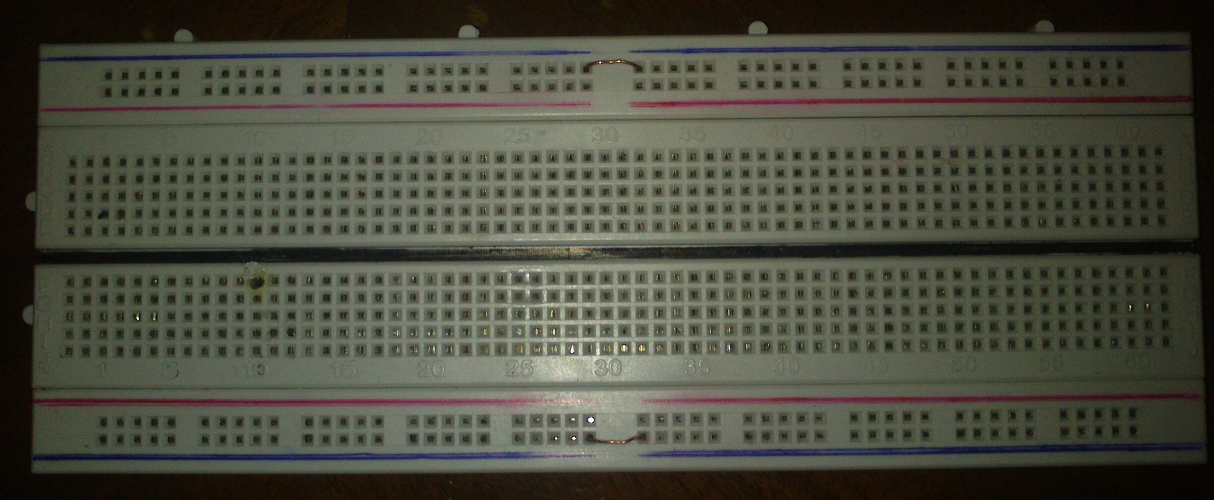

Step 4: On Test Board :
after we connected the components
it's well be like the first picture
we connect the leds directly to controller because they deserve just 10 mA from 1 pin
and from all pins 60 mA
and my controller can resist this value (it can resist up to 300 mA)
