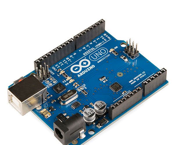

Step 4: Simple Arduino Sketch to Turn on PIN-13:
step1: upload the blink.ino file to your arduino uno board
