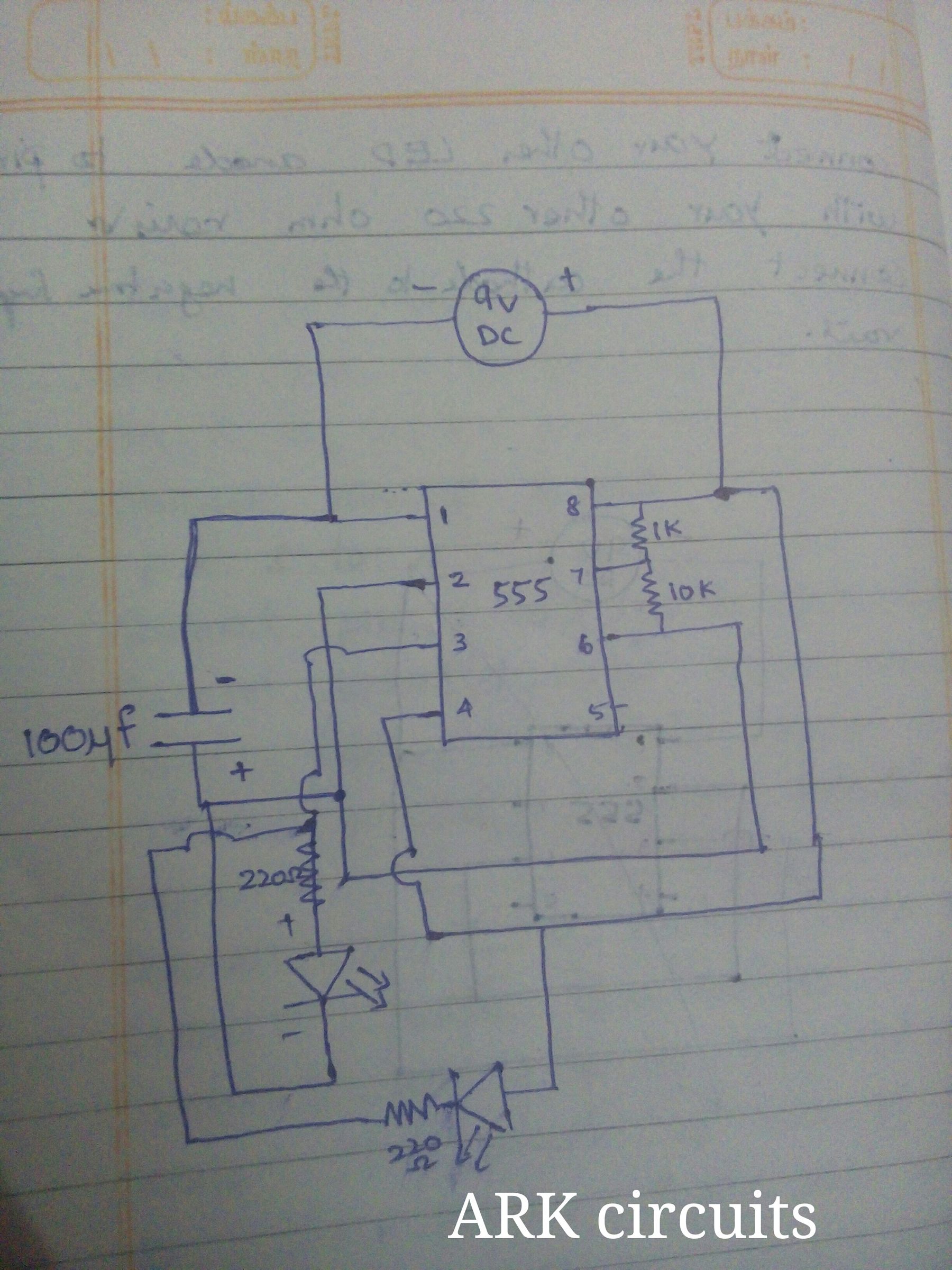

here is the circuit diagram.!

Step 2: Connecting the Components
1) mount the 555 ic in the middle of the bread board
2)connect pin no 7 and 8 with 1 k ohm resistor
3) connect pin 6and 7 with 10k ohm resistor
4)join 2nd and 6th pin
5) join 4th and 8th pin
6) connect pin 1 and 2 with the capacitor
7) take a separate line from the pin 3 and connect one of the 220 ohm resistor to it, and connect the anode(+) of one of the led to the other end of the resistor and connect the cathode(-) of led to pin no 2.
8) connect the anode of another led to pin 4, then connect the another 220 ohm resistor series with it
9)connect the another end of the resistor to pin no 3

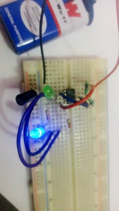

Step 3: Testing
connect the positive end of the battery to pin no 8 and negative to pin no 1.
You will see the LEDs flashing alternatingly... plz try this @ home it will cost below 2$.
