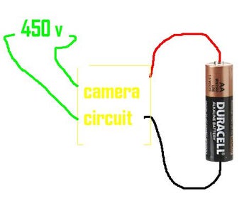

Step 4: More Rewiring
After removing the capacitor and attaching wires for the battery input (1.5v) we attach the output wires which will take 450V to our electrodes. this is done by attaching wires into the holes where we removed the capacitor from and soldering the new wires in place. (you might want to colour code your wires(red for battery positive,black for battery negative,green for high voltage output) but i did not do this.) Also you can remove the small lamp on the circuit which provides the flash, do not remove the led because this allows us to continue using the circuit as a capacitor charger for as long as we can see it. Then we must find the charging switch, we want to solder this in the closed position. The switch is usually a small metal flexible pad that can be pressed against to join two contacts on the circuit board and complete a circuit, we can remove it just by twisting up a few of the curved pieces of metal attaching it to the board and pulling. Then either solder in a wire to connect the two electrodes( join it to the bare metal) or use a drop of solder for the same job, this will ensure that the circuit is always charging and therefore producing 450V.
Step 5: First Test
At this point before we go any further we should check that the previous stages have been completed correctly. attach the positive input wire to the positive end of a battery, the output wires to a voltmeter or your finger if you dare, and the negative input to the battery's negative terminal. You should see the voltmeter read 450V (or something higher than 200 atleast) or feel a strongish shock( I don't know what to compare it to I haven't had many others).This indicates that the transformer in the circuit is succesfully converting to a higher voltage and that the current is being pulsed by the circuit so that the transformer can use it. If you do not see a high voltage or get a shock check the previous steps carefully, see if you went wrong somewhere. Is there a connection loose, if not try using another circuit from another camera.

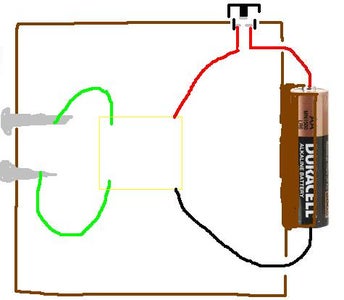

Step 6: Constructing the Shocker
Now we have a working circuit we can assemble the housing for it, start by making a hole in one end of the box with a drawing pin and then placing a screw into it and twisting so that the screw digs in far enough for atleast half to be inside the box. Repeat this process a few millimetres to one side but make sure the screws are atleast 4 or 5 mm apart at the closest point. Also drill narrow holes for the wires to connect to the battery holder then glue this to the outside. A hole drilled for an on and off switch is advised but is missing on the prototype. the completed case should look like this diagram.
Step 7: Connecting the Box to the Circuit
Solder the output wires from where the capacitor used to be onto the inside ends of the screws and thread the wire from the negative input out one of the holes you drilled near the battery holder before soldering it to the negative end of the battery holder. Take the positive input wire and attach this to one end of your on and off switch attach another wire to the opposite end of the switch and connect this to the positive end of your battery holder, you should try to make sure that all the wires stay inside the box except for the input wires going through the holes to the battery holder. Then close the lid of the box and screw it shut.
