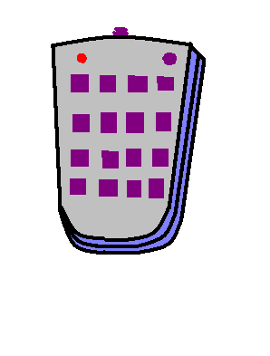

then splice into the wire you ran and solder the pigtails to the wire. ... I had no photo of this so I made a simple drawing to show an example.
