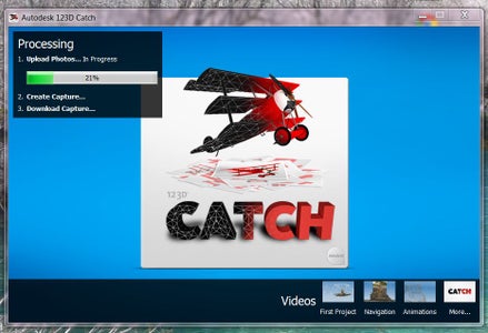

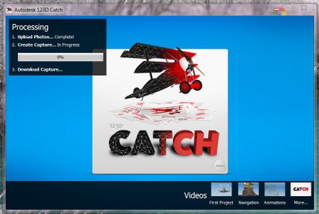

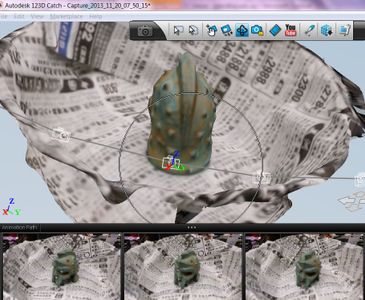

Step 4: Part 4: Upload Pictures to 123D Catch
Combing part1,2,3, setup a stand for the android device to take pictures.
copy the 31 images from android phone to be uploaded to the 123D catch

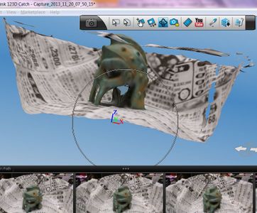

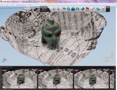

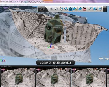

Generate a 3D model from the pictures uploaded
Note: no model generated yet, and I have waited for close to 30min to save the project but without success.
Some fine tuning is required: I noticed the picture taken by my android device was out of focus. Maybe that is the reason why the model was not generated. to be updated.
Edit: For some weird reasons, 123D catch online version does not work on my laptop. I have left it running over night and the next day I check my computer, still no model generated. However, the 123D offline version does work, using the pictures generated by sixpence 3D scanning kit.

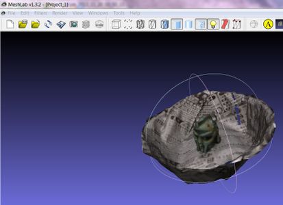

Step 5: Edit 3D Model With MeshMixer
Use MeshMixer to select the news paper portion, delete by pressing the "x" key.
subsequently touch up to become a watertight model.
