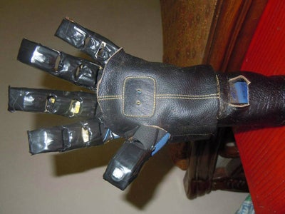

- I'm Sahil Rohilla, and I love to make weird stuff out of electronics! It is my passion. For this project, I'd like to take you through my process of creating Smart Glove, a functional cell phone that you wear on your hand. I see it as my first attempt at giving something back to the online communities of makers I've been learning from
- The idea came into my mind when one of my friends had to remove his gloves again and again to attend his phone calls in a touch screen phone in winter. So I thought why not to build something that we can wear every time and that can act as an alternate for our cellphone
- After 18 days of research and 2 prototypes I was finally able to build a calling glove that I named as smart glove. The dial pad is in our fingers like we used to count digits on our fingers in our childhood the speaker and the microphone are in thumb and little finger respectively. Though the model is still in testing process but is still working outstandingly

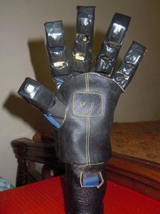

And voila here is the basic shape of my glove with non-functional key (till now)
Right now the fingers were either a little tight or a little loose so I had to modify the fingers a little bit. Also some other thing needed to be modified and fixed.

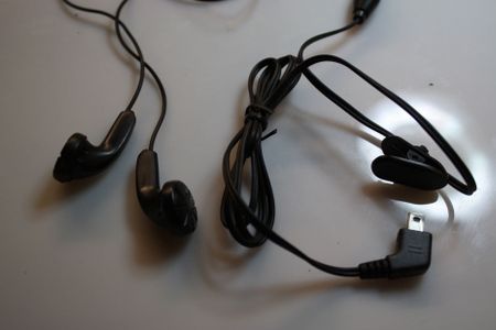

I got a pair of earphones that were of no use for me as they had a different type of jack that does not fit into my cell phone. Also I needed speaker and a microphone and both of these things were inbuilt in this.
So i opened it and soldered both microphone and the speaker with couple of wires in place.
Both the microphone and the speaker are soldered to the speaker wired that i got from the earphone itself.

I began wiring the glove by selecting the type of wire. I tested a lot of different kinds of wire, and ended up settling on headphone wire. Yes, like the wire in your favourite pair of ear-buds. This wire is ideal for a few reasons: It is flexible, low profile, durable, and each strand of wire is individually insulated. It is a bit harder to solder because of the insulating coating, but is worth it in the end to have wires that aren't super bulky and that won't break on you.
Now that I had all the things for the project to be completed I made all the wires of the terminal buttons on the fingers and on the PCB connected using solder wires and the heat shrink tubing.
Luckily, the cell phone I used for this build came along with an external headset that contained more than enough wire for the entire glove.

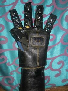

Likewise I have the buttons 1 2 3 on my index finger 4 5 6 on my middle finger 7 8 9 on my ring finger and * 0 # on my little finger. The dial and disconnect buttons are on the thumb itself. Now doing that I made an extension for my glove so that it fits to my hand very well and also I get a place to hide my phone in.
The above picture shows a little window right there. That window is actually made in order to see the screen of the phone. The screen show who is calling or what number are we calling. The rest of the components are either ordered online, or come from the cell phone I hacked apart. Now that I have all the parts of the glove it is time to make everything look pretty before final assembly.

Step 7: Final Assembly
Now the only thing left to do was attach the last few components,and show a little more creativity. I mentioned the buttons under the masking tape with the help of fluid and also I covered the phone with black tape to make it look a little neat
also I made a little window through which I can see whatever comes on the screen neat.
And here is the final product that what I was talking about.
***Now that everything is snapped, soldered, bolted, and epoxied in place, it's time to take this thing on a test drive!***
Step 8: Smart Glove: Demonstration
It's alive!! Maybe if I make a gold-plated version I could try to sell it to Kanye West or something. Thanks so much for reading! I hope you found help and/or inspiration from this Instructable. For more information,or any other enquiry email me at sahilrohilla77@gmail.com or call at 8447481267 Cheers!
