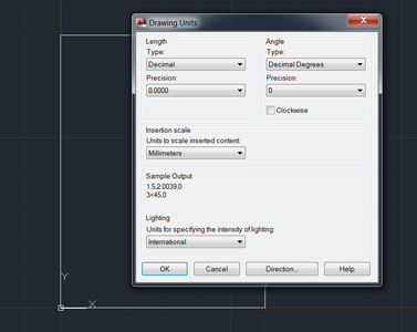

Step 2: Software Setup
Lets begin to set up our Autocad project. Usually laser cut machines work with millimeters, so I set that unit in insertion scale parameter. Add a grid so that you can count centimeters on the screen. Then create a layer (the green one in my case) for dimensions, so that you can hide them if you need.
