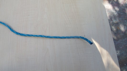

as soon as I unwound the bundle of cord from the dollar store it began to unravel. I cut off about a foot and flamed the new end.

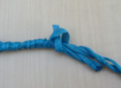

I decided on the size of the loop by roughly forming it and pinching the long end of the cord at the base of the loop, a slight twist opened the cord wrap and I passed the end through, twisted it back tight and opened the next wrap again passing the end through and repeated that process for about 3 inches

this type of splice doesn't really need to be wrapped which is another way to secure a loop in a line but I had those cut off pieces right there so...
lay your wrapping line inside the loop, holding the short end against the line, wrap the long end around so it secures itself and continue wrapping until you run out of wrap and pass the end back through the last loop and pull it tight
