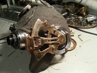

4. The whole mask was coated with liquid metal and later it was sprayed with salt water. After two days produces a rust patina.
5. a transparent plastic hose, illuminated from one side with an LED, was added and covered wit a spring
6. The part of the left side is an old sextant, made of brass. The "eye" is a lense from an old camera.
7. Inside the mask was covered in leather and stitched with steel wire.
8. Old electric cables and brass screws were mounted outside to the helmet.
