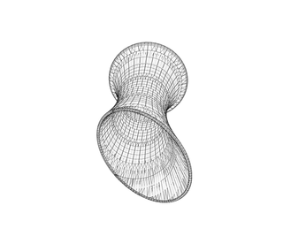

Step 4: Print 3D Model
Download the 3D model and print it!
It will make the light more beautiful and practical.
Also, it can hide the white board with led lights in it.
And you can see it looks beautiful when the lights are on.
