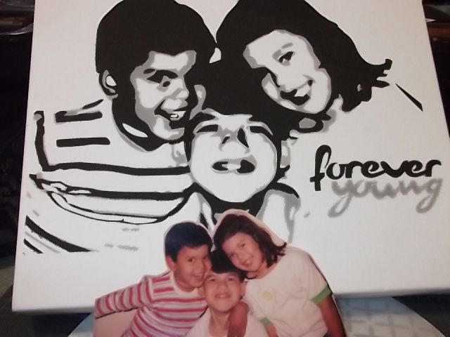

now the printer is ready to print just put the t-shirt holder and a t-shirt (white or lite colors only ) to make a test : )
Step 10: Finish Machine : )
you can put some of the plastic cover back to the printer
thank you all for you're attention on my first instructable hope it helps some one.
