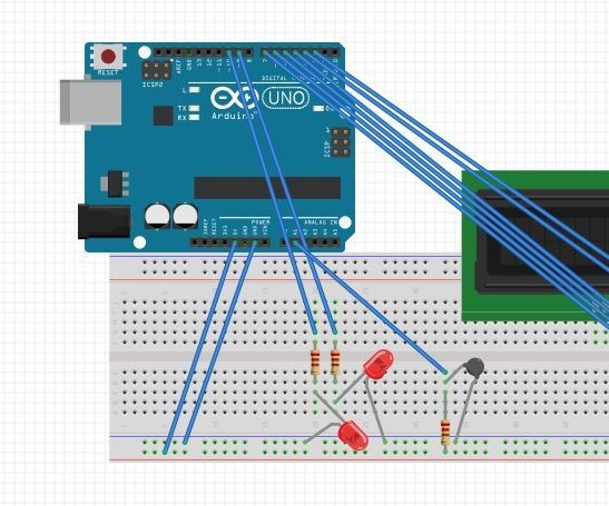

This circuit will display you the temperature. You can make the circuit with a lm339n or like my circuit. My circuit is the easy way, and with a lm339n you will need a potentiometer and some extra components. as a add to this, there is a connection problem, the resistor on the thermistor must be connected at the voltage. I will change the scheme tomorrow.
Step 1: Make the Circuit
I have use a 10k thiristor, 10 k resistor, 560 ohm x2 resistor and 2 LED-s and 6 or 7 wires.
If you want to have a stronger light from the LED you need to put in your circuit a smaller resistor, 100 ohm is perfect. Unfortunately at the moment I don't have at home 2x100 ohm resistor just 560 ohms.

Step 3: Display
You can show the results on a display but also on the serial monitor from the arduino. My display is not working so I have display my results on the serial monitor fron Arduino program.
