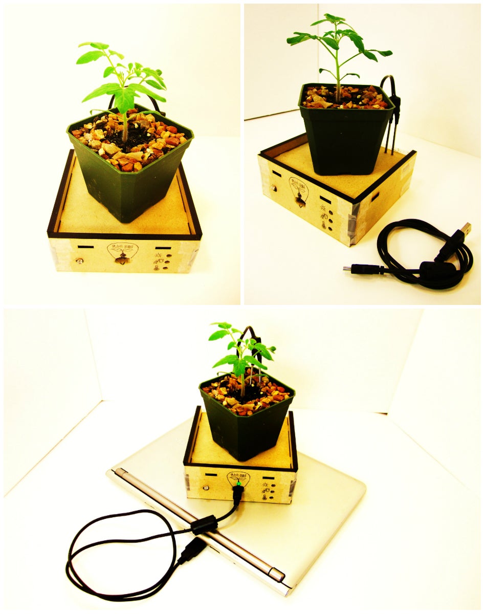

Step 1: Frame
I can be made from many different materials. mini is currently made out of 6.4mm MDF board. My current dimensions are 18x18x6cm. I can be custom made to any size (please see the last step's pictures for a 9x9inches version on the wall).
Plant shelf mini can be laser cut using;
metal
wood
plastic (*3D print) .
I can be hung on the wall with an easy slide on/off system. Once installed no tools are again necessary to attach/detach me. I am cut very precisely so that barely any amount of basic wood glue is needed to secure me together. I can also be used on any flat surface.
attached illustrator file can be used to laser cut me. minor tweaks may be necessary, please ask before cutting !

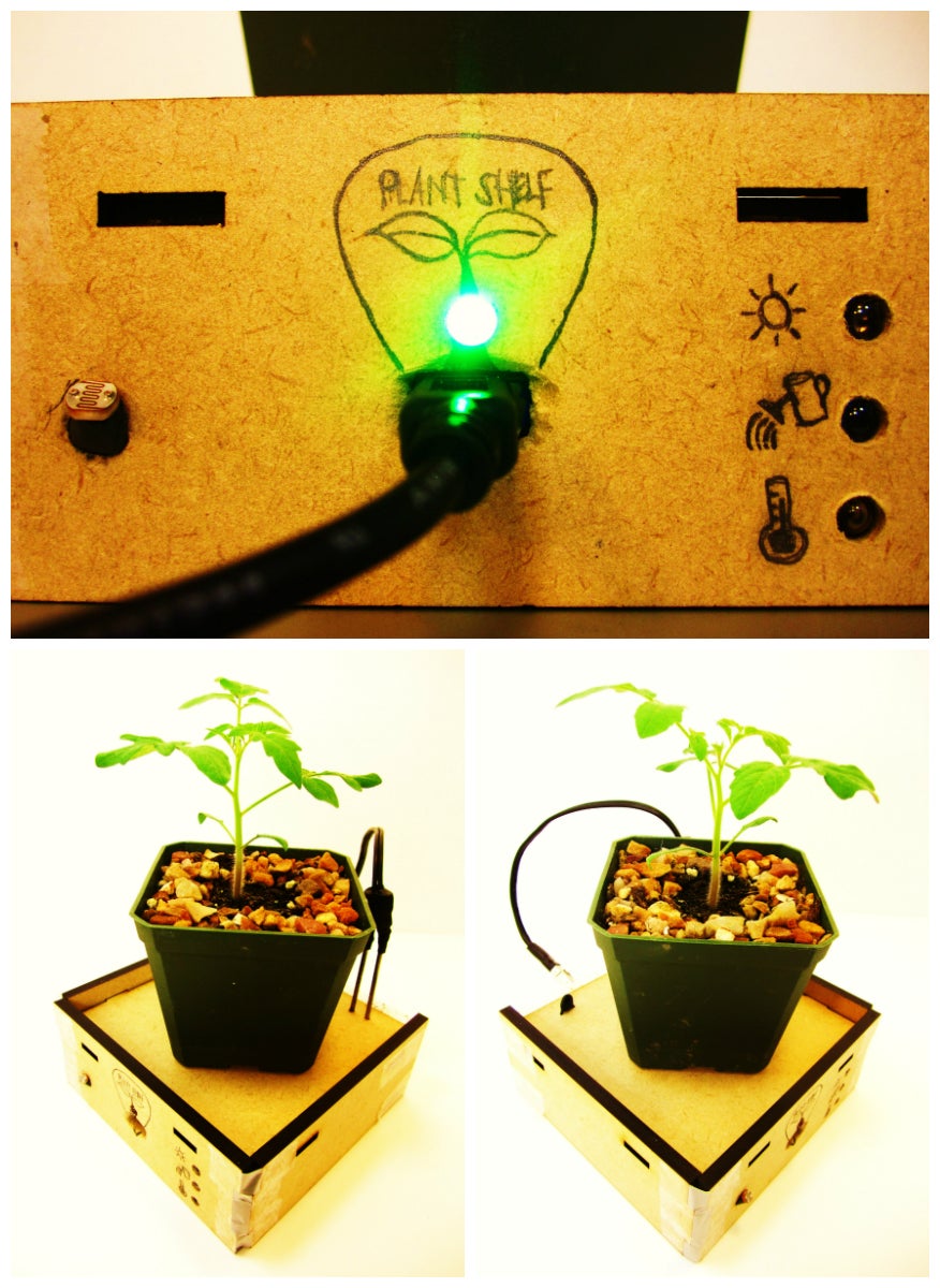

Step 3: Built in Plant Doctor
Green light means every condition is as needed for the current plant/strain automatically through our online database. the end user simply enters the plant type and age on the webpage
Yellow means plant is sleeping (no light) or fault in the lighting system, if the light is off during ON stage. .
Red means the plant is too cold or hot depending on the season.
Blue means the plant is thirsty.
Once either of the sensors are triggered I can send an e-mail, sms or even voice call a phone number. The user can turn on the webcam and see live footage of the plant and read my sensor data on the cloud.
Just attach the sensor to the soil and I'm ready to collect data.
