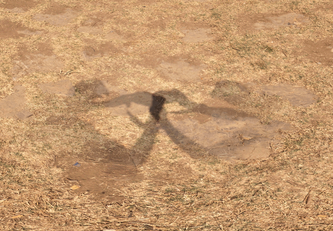

Step 12: How to Become a Ghost
Obviously you'll surely expect to find the tripod or the photographer feet at the bottom side of any 360°panorama... and indeed you'll find it in many cases. But any professional and meticulous photographer will abhor that! So it's essential to find a way to hide these unrelated elements. You have three possibilities:
- you can replace them with a more professional element, like a circle or a sphere with your contact data:you've to elaborate the final image to do this, and we'll see that in last steps
- you can recreate the ground or the pavement with some postprocessing work: we'll see that too
- you can try to empty the area under your camera when you shoot the nadir: in this case you have to take more shots (maybe 4 instead of one if your're using a wide-angle lens like mine) moving away your feet or tilting the tripod so that neither shoes or tripod legs will appear in images
The last technique is obviously the one that lets you stitch the images faster, but it's not always possible.
I bet that if you are a diligent student you have already noticed that ghosts have no shadow, hiding your own shadow needs the same trickery as the nadir cleaning, look the following animated gif to see how to take two different shots so that the software hide the most part of the shadow, then you have to hide the remaining part by hand.
