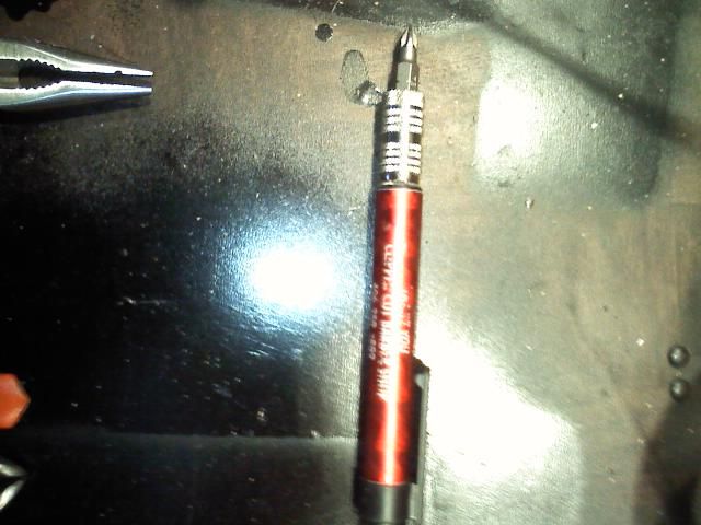

Step 3: Ready the Flash Light
This part is actually the hardest part... First take out the batteries , then you need to take your dremel tool, and cut the laser pointer in half. the put the remaining half with the laser, and flash light, and put it in a vice, Not to tight, it is only aluminum, so it's very easy to crush. Then take your pliers, and clamp them onto the top, where you see your laser come out of, a little ways down, there is a seam, this is glued, so if you grip hard and bend it back and forth, it will come out. Then take the circuit board out and desolder the two push button switches, and save them, also take out the little rubber covers, which you see on the outside, and push on to turn on the light. there should have been a heavy duty thick aluminum holder in the cap, take this out and pull out the transparent 3mm LED, and solder another 5 wire from the white prong on the led(prong with white rubber insulator) and take it and solder it on a prong on one of the pushbutton switches you saved from the laser pointer. then on the other prong on the same side on the button switch the right or left prong depending on what side you soldered the other wire on, solder a 4 wire from there to the middle prong of the switch you used for the tv jammer. then take a 3 wire from the prong with yellow casing and and solder it to the ground on the tv jammers circuit. You're
