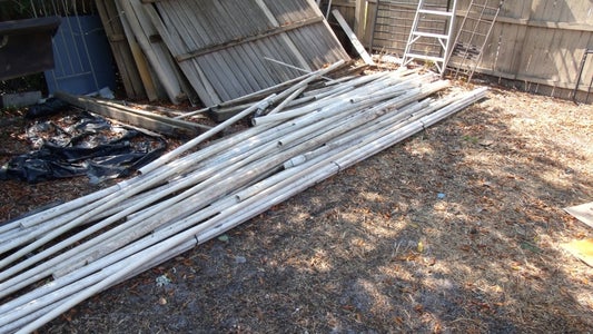

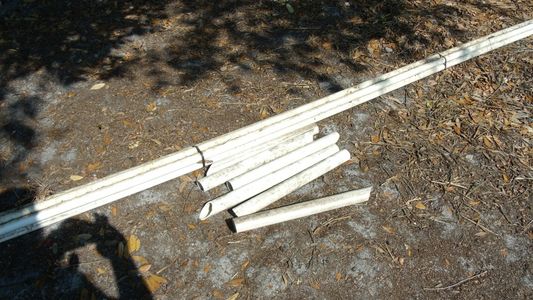

My first step was to stare at this mess of pvc pipe I found and brought home, hmmmmm, those 1" pipes could make a hoop house... Those 2" pieces could make supports. I should explain that here in Florida driving stakes into the sand doesn't give much support unless your using a screw type mobile home tiedown stake 3 or 4 feet in the ground.

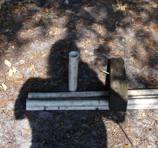

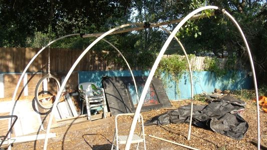

I cut a couple of sand spikes from the 2" pipe about 20" long ( a sand spike is usually used by surf fisherpeople to hold their fishing poles, its a piece of plastic pipe with one end cut at an angle and occasionally a slot for the reel) I then drove the "spikes" into the ground. (Next time I need to remember to measure and use a straightedge !) Then I placed the lenghts of 1" pipe into the "spikes" to form hoops. I didn't want to cut the pipe or go get connection pieces so I grabbed some odd pieces and duck taped them as support
Step 3: D+

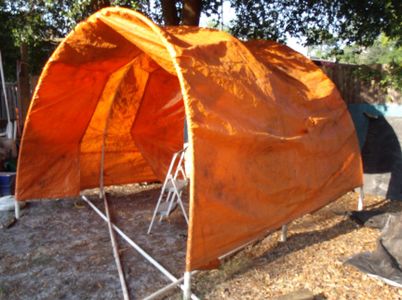

Ok so I threw an old plastic tarp over the hoops (here's where those of you who plan everything out and measure twice may have the advantage) it sort of worked....

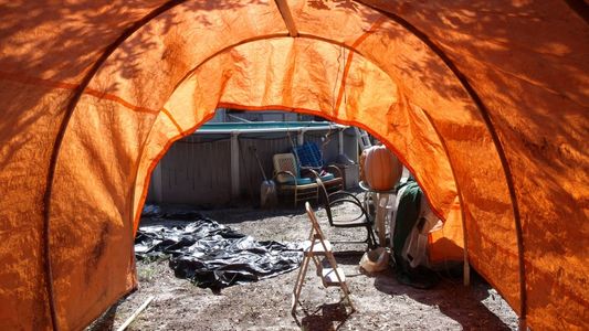

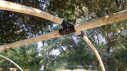

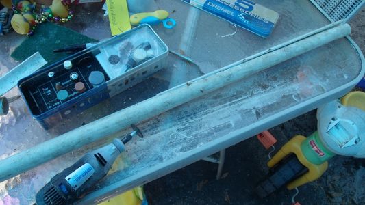

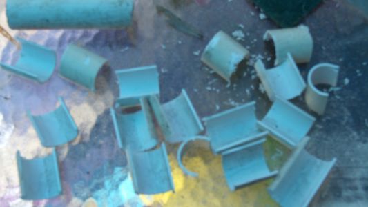

Ok it doesn't take a lot of imagination to realize I needed another hoop and a better way to attach the tarp. I grabbed a short piece of 1" pipe and using a dremel with a cut off wheel removed about 1/3 from one side and then cut out 1-2" pieces, yes a table saw would have been easier but I don't have one, Next time I'll cut the pieces to length before cutting them open. Then I added another hoop, the "clamps" I just described making clip over the pipe hoop with the tarp between them
Step 5: Conclusion

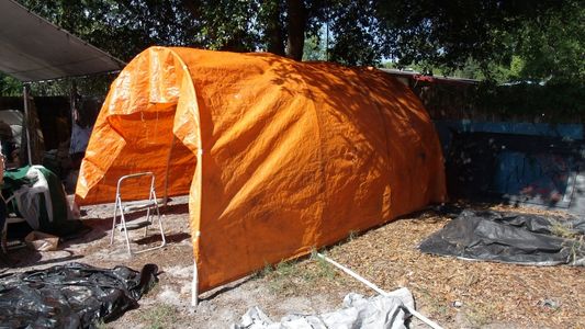

Well this was just a test build and I realize that even though this structure stood up to a fairly fierce thunder storm I need to cut the pipe and use some T connectors at the center ridge and perhaps on both sides, also some tie ropes front and rear would probably help. Now its time to take it down and clean up some of this mess Ive made. I have about a half hr build time involved not including going back and forth across the yard to get more material or stopping to take pictures
