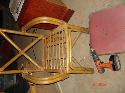

I'm gonna turn this old chair into a portable stand for my miter saw here. ( as shown in picture #1)
Step 1: Removing the Seat From the Frame of the Chair

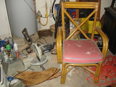

First i will need to flip the chair upside down to access the screws holding it to the frame of the chair. (as shown in picture #1) Remove the four screws and set aside for attaching saw to chair. Remove the seat cushion and flip chair right side up. (picture #2)

In order to remove the arms from this particular chair i will need to cut the straps holding them to the frame of the chair. ( as shown in picture #1) The arms are now removed from the frame. ( as shown in picture #2)

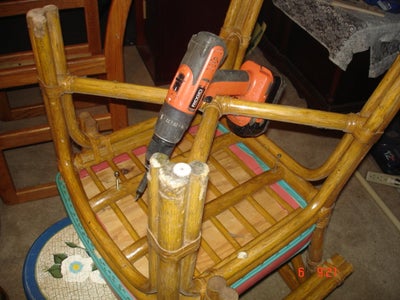

After removing the arms i will use them  for out-rollers to hold long boards that i cut on the saw. I will drive a screw through the end of each arm ( as shown in picture #1)  so it wont pull out from under the saw when its slid into position. These screws need to be drove parallel with the upright of the arm ( as shown in picture #2)
Step 4: Mounting the Saw to the Chair With the Arms (outrollers) Positioned Under the Saw.
Position the arms under the saw before mounting the saw to the chair.( as shown in picture #1 & 2) Once the arms and saw are in position, i will use washers and the screws i set aside earlier to mount the saw to the chair.( as shown in picture #3) Tighten screws so saw is firmly attached to chair.( as shown in picture #4)
