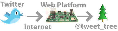

Tweet a color to @tweet_tree on Twitter. A business card size server connects to Twitter once every few seconds and grabs new tweets. A multicolor LED in our fiber optic Christmas tree fades to the new color.
If there's are more than one color in a tweet, or multiple tweets, the tree fades between them until it reaches the most recently sent tweet.

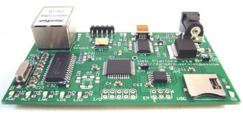

Web platform
Our open source web platform does the heavy lifting. It has all the hardware we need to connect to Twitter, parse tweets, and convert them to colors. The color(s) are stored in memory and sent to the ShiftBrite LED over a simple 3-wire interface.
The web platform is available as a kit for $35, including worldwide shipping. For an extra $5 Seeed Studio will assemble it for you.

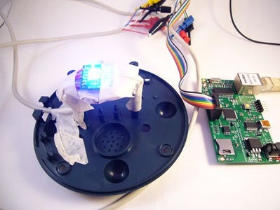

ShiftBrite LED
A ShiftBrite high-power LED blasts the colors sent in the tweets.
  • IO2->LATCH
  • IO3->CLOCK
  • IO4->DATA
  • GND->GND
It only takes three pins to control the ShiftBrite, we used IO2-4 on the web platform IO header. The EI pin should be permanently enabled by connecting it to ground. The module requires a 5volt+ power supply, we tapped the same supply we used for the web platform.

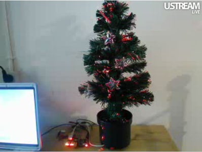

Fiber optic tree
Our tweet_tree is a small fiber optic Christmas tree, but you could use more ShiftBrites to light a full-size tree or yard display.
We removed the original guts from the base of the fiber optic tree and replaced them with the ShiftBrite. A major concern was that the LED wouldn't be bright enough to replace the original mini-halogen lamp, but the ShiftBrite works perfectly.

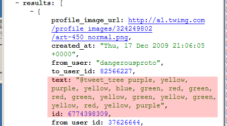

The firmware uses an adapted version of the #twatch source code to connect to Twitter over the internet. It opens a TCP connection and sends a search query for '@tweet_tree', the response is a JSON formatted data file like this.
A JSON parsing state machine searches through the data for the 'text' and the 'id' tags. The text tag value is processed for color commands. The value of the first id tag is stored too. We'll use it to limit results to new tweets in the next search query. Hint: try JSONView to work with JSON in Firefox.

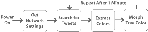

If a new color command is found, the LED fades into the new color. If multiple commands or tweets are found, the colors morph from oldest to newest, with a 5 second pause between each. The tree always ends on the most recently tweeted color.
Every minute, or after completing a stored sequence, whichever takes longest, the web platform queries Twitter for fresh tweets. It appends the saved id tag value to the search query so the feed only returns new tweets. Twitter limits the number of queries you can make in an hour, but 60 is well below the limit.
