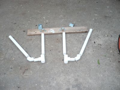

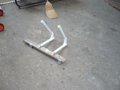

Step 1: Get the Pieces
Parts List:
1" Schedule-40 PVC pipe
2 x 12" = vertical
2 Tees
2 x 2" = horizontal
2 45 degree Elbows
2 x 18" = ForeArms
2 pipe clamps
2 2x5 mending plates
1 piece of 1x4 x 30" pine scrap
Total is less than 10 bucks at Home Depot
2 x 12" = vertical
2 Tees
2 x 2" = horizontal
2 45 degree Elbows
2 x 18" = ForeArms
2 pipe clamps

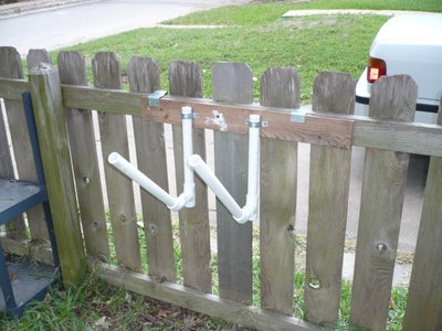

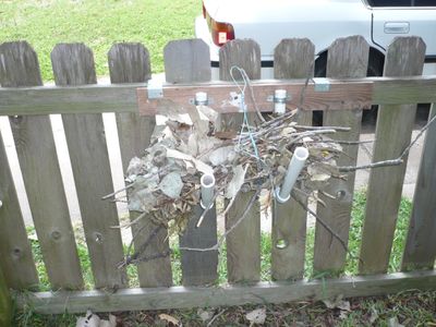

Step 2: Test the Position on the Fence
Try fitting on the fence somewhere and putting putting some branches in it.
Notice how you can get the twine underneath and behind it to tie it into a snug bundle.
After you are satisfied with the dimensions, glue the pipe fittings together and stack and tie twigs.
I hope it works for you. It works for me. I'm glad that I finally got around to it.
