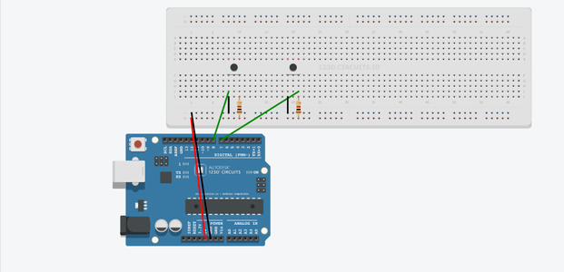

Step 1: Step 1: Wirring Up
  1. Put the shield on to the Arduino
  2. Wire it up as on the image.
