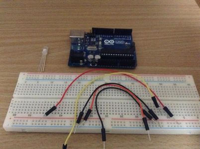

Hi guys this is my first instructable and I will be showing you how to control RGB (Red Green and Blue) LEDs. its not that hard to do but the materials you will need are;
-An Arduino Board
-RGB LED
-jumper wires
-breadboard(optional)recommended
-And a computer of course to send code to your Arduino.

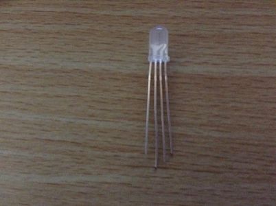

First you need connect the LED to the Arduino. The longest pin on the led is ground, second longest is blue, third longest is red then the last pin is green. The Arduino sends an output to a pin which lights the LED.

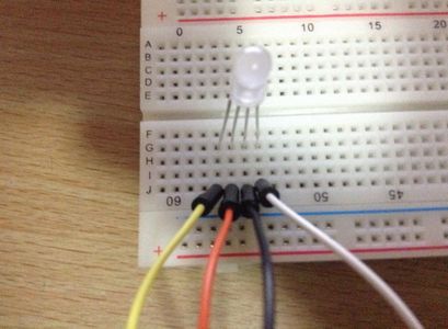

in this step im going to use the colour code in the picture above. Ok first the orange wire is ground and goes to the Arduino GND pin. The yellow to Digital pin(PWN) 10, Black to 9 and white to 8. Make sure that you have done it in this order because the coding is this way.
-orange wire=Ground
-yellow wire=Green
-Black wire=Blue
-White wire=Red
