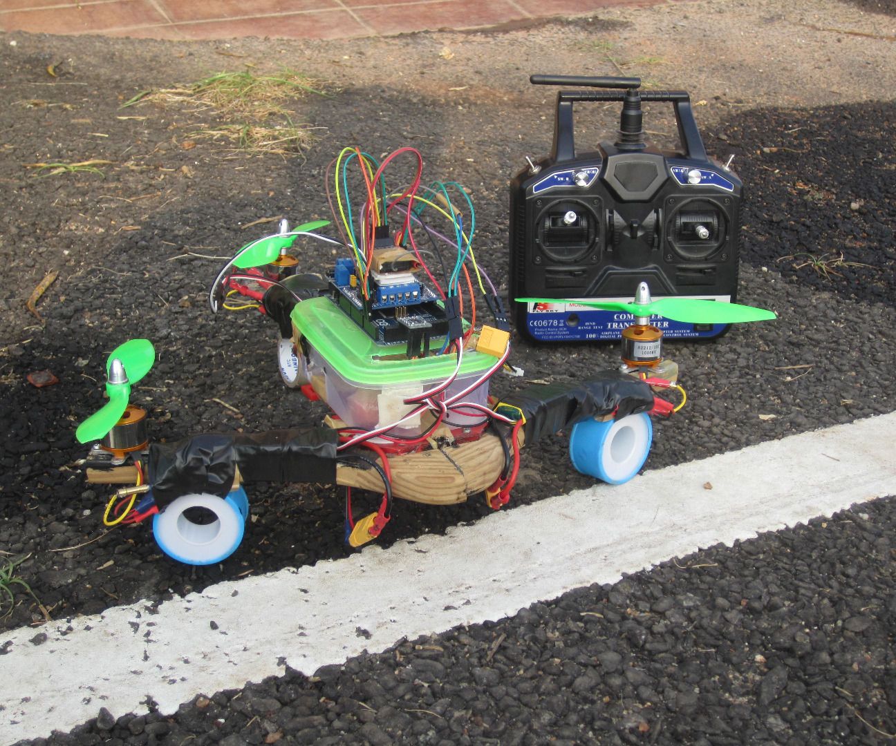

How would it feel using all 6 channels of an Rc receiver controlled by a 2.4 ghz tx? Well fun! I had a few problems which i got help with the author foamboardRc. Here is a project which took me no more than 5 minutes. If you have any problems please ask i will answer as quickly as possible.

Batteries. I scavenged mine from a powerbank for the mobile phone. 7.4v 2600 mAh.
NEVER power your receiver with over 5v or it will get fried. Mine had an inbuilt 7805 so i could risk it. I am not responsible for any fried receivers.

Step 6: Connections.
of the 6 channels i found channels 3 and 4 easiest to use (elevator and ailerons).
you can use any, your convenience.
