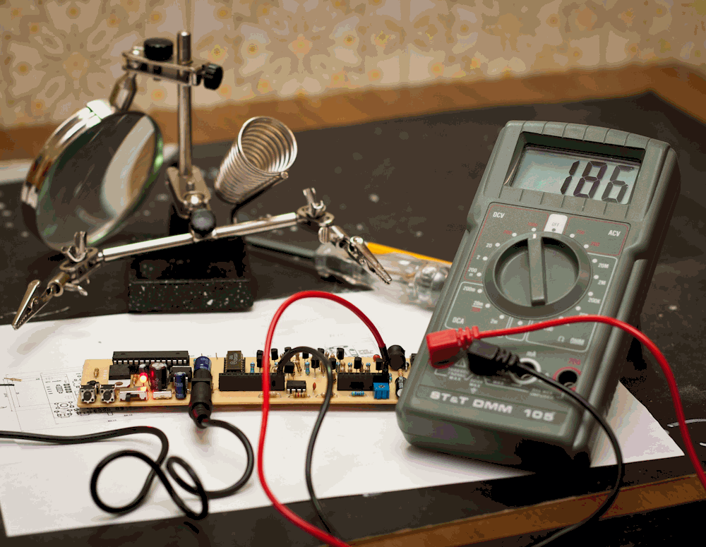

Step 6: Solder Components
When your boards are etched and drilled (or arrived from 123D Circuits), you can solder all the components. Then cut all the pins which stick out the bottom side.
If you look at the animated gif you'll see that the voltage is set, turning the potentiometer, so that about 180V comes out of the TEST pin. This voltage is a little bit lower on neondots pins (which have a proper resistor) and is about 1/6 of 180V on the other anodes (which are multiplexed to cover all the six digits).
