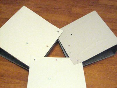

Step 2: Connect the Three Cases
Drill holes and bolt the three cases together to form a triangle. I used three 2" bolts.

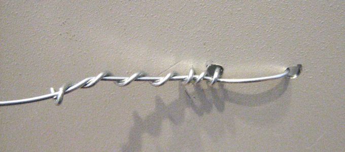

Step 4: Attach Hanging Wire
drill four holes to attach a hanging wire.
Separate the two inner holes by 18-20 inches so it can hang from two studs (assuming studs are 16" apart).

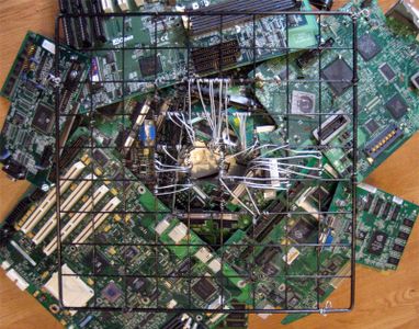

Step 5: Attach the Circuit Boards to Frame
This step may be time consuming, but you get the hang of it fast.
For a frame I used an old wire shelf (probably from a closet organizer).
First, remove all capacitors from the boards. Use hands or pliers (beware, pliers can damage the capacitors).
Set the capacitors aside for later use.
Next, cut pieces of wire ranging anywhere from 5" -15" long.
Connect the circuit boards to the frame. Mess around with placement first. I started with large pieces on the outside, smaller boards toward the center. I recommend using at least three connections on larger boards.
Don't forget to leave an opening in the center for the small light socket.

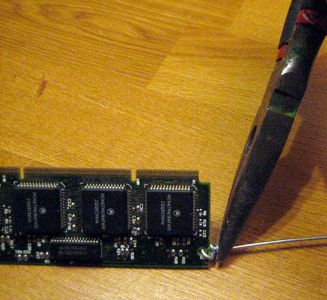

Step 7: Attach Capacitors
Cut a 15" long piece of wire for each capacitor. (I had around 40).
Insert a wire into each capacitor. The wire should go about half an inch in and be snug. You may need to use pliers to hold the wire while inserting into the capacitor.
