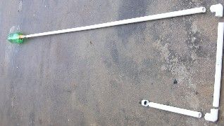

Step 5:Glue/solvent weld the pipes
At the very least you have to glue the end cap onto the long pipe. However, for a few more pennies you can end up with a "J" shape which has two benefits. First, it tends to keep the end of the valve stem from scraping on the ground. Secondly, if the check (one-way) valve in your air pump is leaking a little, the vertical rise should trap some air, so air will leak back into your pump rather than water.
This is how it will go together. Notice that the bulge end of the long pipe (and the bottle that it seals on, green in the picture below) is not glued into an elbow. The other end will be.Slather some cement on the inside walls of the end cap. Make sure you do not apply so much that it blocks the opening to the valve.
Slather cement around the end of one of the 30cm (1') piece of pipe. With a twisting motion, push the pipe into the end cap. You can wipe off the little bit of cement that squeezes out.
Repeat with the elbows. Make sure the end of the long pipe that DOES NOT HAVE THE BULGE is glued into the elbow. Set the pipe aside so the glue can dry.

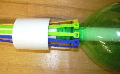

Step 8: Cut and drill (or tape) the slide pipe/trigger. 1 1/2" diameter schedule 40 pipe is very common.
Cut about 50mm (2 inches) of 1 1/2" diameter, schedule 40 PVC pipe.
Take a moment to see how the slide trigger/pipe works. Take the bottle off. Slide the slide trigger/pipe on the end of the long pipe and over the heads of the ties. Put the bottle back on--pressed onto the bulge as shown in the picture below.
Slide the slide trigger/pipe back over the heads of the ties. Now you should not be able to pull the bottle off. When you tip the launcher vertically so the bottle points up, there should be enough friction between the short trigger pipe and the ties so the trigger pipe does not slide down just from the pull of gravity. If the trigger pipe is so loose that it slides down by itself, the water rocket will be launching before you are ready. To increase the friction so the trigger pipe does not slide down unexpectedly, put some electrical tape (duct tape would work too) on the inside of the trigger pipe as shown below. drill a 1/4" (7mm or so) hole near the end of the pipe. Thread the end of the rope through the hole and tie it so it does not come out.

Step 10: Adjust the launcher
Now that you have the slide trigger pipe done, it is easy to adjust the trigger mechanism so there is no leaking. Put the slide trigger pipe on the launcher. Push a two-liter bottle onto the long pipe and push it HARD onto the bulge. It helps to twist the bottle a little as you push it down.
Lock the bottle on by pushing the slide trigger pipe over the heads of the ties.
Loosen the hose clamp a little with a screwdriver. Pull the tape/ties assembly down, and while still pulling, tighten the hose clamp back up, quite tightly (this might work best with two people, or place the other end of the launcher against a wall).
