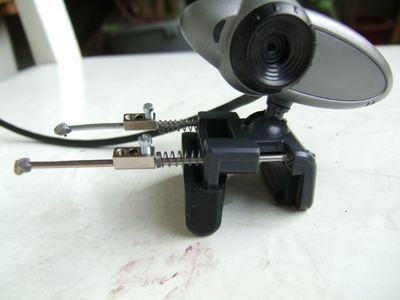

while mending a broken webcam i replaced it's plastic screws with bike spokes, longer springs from worn out click/retractable biros, the screw-blocks from electrical terminal blocks, and some glue stick heated with a flame smudged on the sharp ends of the cut spokes. now it can fit the screen or wooden shelves or even wider objects.
