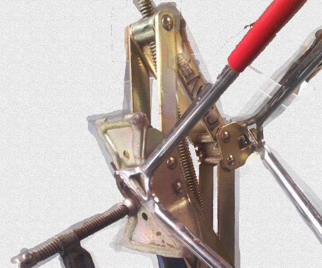

AC arch welding takes place between the electrode and the work.
(remember to double ground as aluminum is a poor conductor and will scar and scab if you just set your work on the table and go to town. I clamp my clamps when I remember, when I forget, I hand in scabby work and usually miss out on pay, and have to endure the rumors that I'm loosing my touch)
