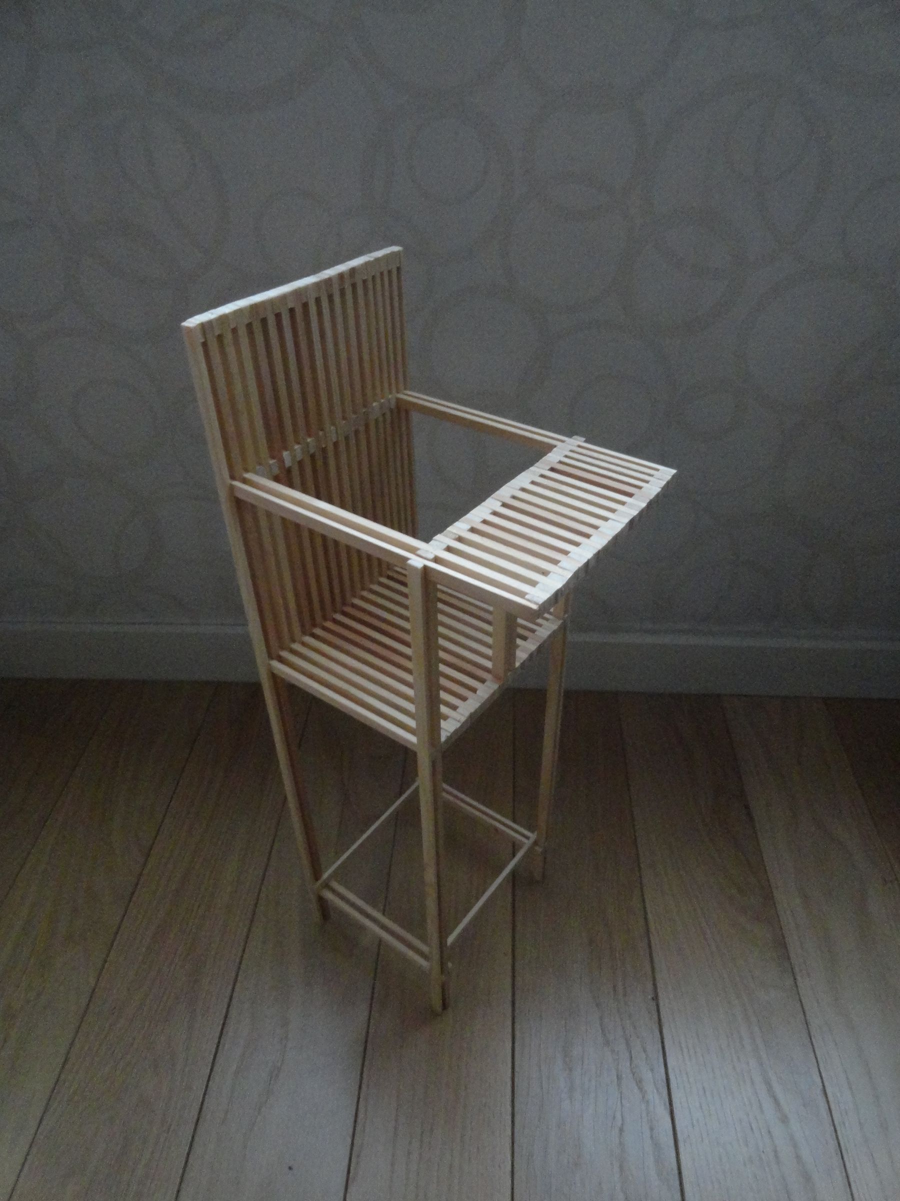

Every wheelchair requires a different design. I find it easy to sketch the possibilities on a photograph. For this chair I chose a design with a tray at the back to overcome the slope, in front three sliders and on the bottom another tray.
In my last step I show another example. On that one for example, it wasn't possible to make a tray on the bottom because there were two cross beams.

Make sure that you first measure everything well and always leave some slack. Start with one side (see photo), because all the rest is rectangular and is located between the twe sides. Start too big so that you can correct, but make sure it does not wring at the end. Once you've gotten everything good you copy the side and then it's just a matter of screwing everything in between.
Unfortunately I can not say much more than this about the building itself because each wheelchair is different. Sorry about that ...
