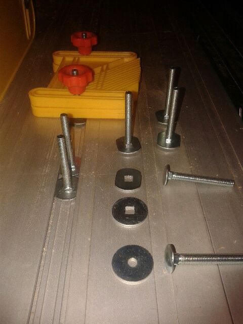

Step 1: Modify Guide Clamp
Shorten guide clamp to height of bottom of your workbench apron. This entails first taking the ends off the clamp any cutting off the rail and bar with a hacksaw or angle grinder. Next re-thread the end of the bar and swap the ends of the clamp round, because the clamp head will be part of the board jack base. Also drill pilot holes vertically through the sides of the clamp head to attach the foot and jack plate with screws.
