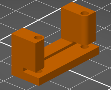

Step 3: Print the Support
I designed the support so there will be no pressure on the Raspberry Pi Zero when we play it. If you need the CAD file, it is here
If you don't have a 3D printer you can ask near by service. It should not be so difficult to get them.

Step 4: Assemble
You can add the supports on two sides of the Raspberry Pi Zero and plug the game pad on it. Please pay attention to the header position. You need to put the header on the line of odd pins of the Raspberry Pi Zero (the ones closer to the center chip)
