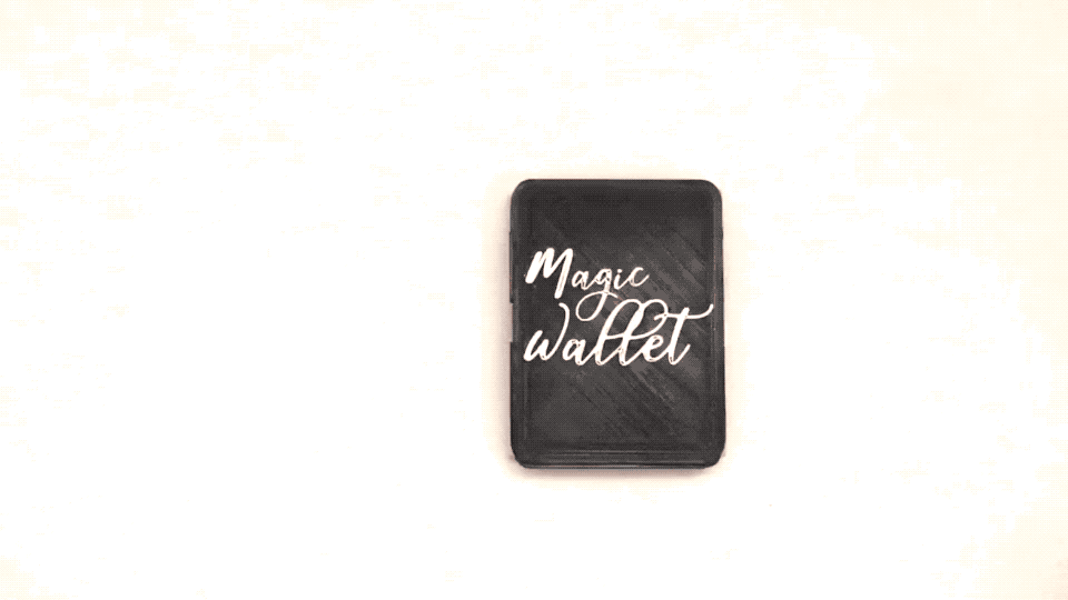

Step 6: How to Assemble the Pieces (1/4: Glue the Ribbons)
Once designed, 3D print the pieces (remember to print 2 pieces of each). You probably noticed that the text "Magic wallet" on the cover is printed in white, while the rest is in black. To do so, I have added the "M600" command on the gcode and changed the filament during the print. Read step 4 in this instructable , I explained with more details how to do it.
It is now time to assemble the pieces, and it starts with gluing the ribbons to the frame:
  1. Glue the upper and lower ribbons on one side of the frame, and the middle ribbon on the other side. I have used hot glue, it is probably not recommended but it is effective within 2 minutes;
  2. Flip the frame, fold the ribbons and place the other frame on the top;
  3. Then glue the ribbons on this frame. The ribbons must be tightened;
  4. Finally, cut the ribbons if they are too long.

Step 8: How to Assemble the Pieces (3/4: Glue the Covers)
Finally, glue the covers on each frame to hide the frames. Again I have used hot glue.

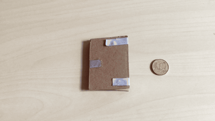

Step 10: Remix Your Magic Wallet
You can also add this "disappearing money feature" to your classic magic wallet if you already own one. I made one rapidly out of cardboard to show you what it looks like:
To do so, you just need to add 2 pieces of paper on each side of the middle ribbon in the wallet, glued together.
  • Cut 2 crosses ina paper. The ones I made are 9 cm long (see the images above for more details).
  • Fold these crosses, and place them on each side of the ribbon of the middle of the wallet.
  • Glue them together.
If you have a wallet with crossing ribbons, I guess it works the same way. Please feel free to post an image if you try!
