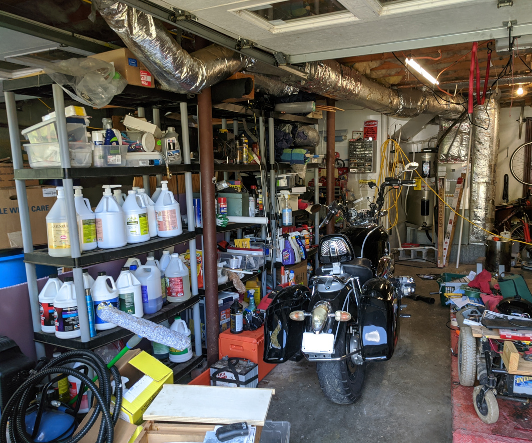

Remote controlled electric motor base
Of course you already have a remote control mower or similar unit because they are all over this website. I use mine to haul wagon loads of firewood or with trimming attachments but this time of year the sirens call cannot be resisted, I must make it into something spooky. With the quiet electric motors it is begging for a flowing sheet and glowing eyes to give neighborhood children a ghoulish surprise.
The base unit has two 12v batteries that will serve as ballast since we'll have a higher center of gravity and can also power any additions, the 24v motors won't have any trouble with getting around. It moves at a human pace but rolling will give it an eerie lack of gait and if it hits bumps it will shake and cause an abrupt flick accentuating the flowing sheets. With the controller one can change direction quickly in response to people around it but do be careful.
