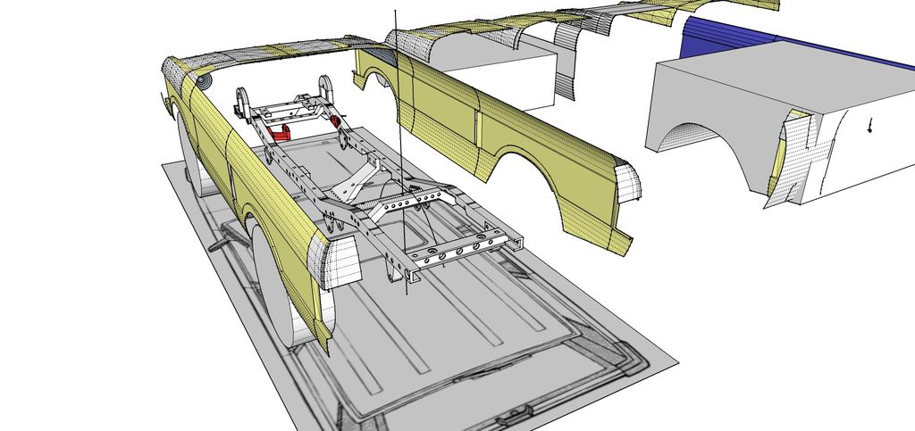

My Approach to the Overall Design
- Import a front and side view and scale to 1:10th
- Make a very rough model of the body shell
- Model all of the bought parts (axle, motor etc)
- Design and model the frame and suspension
- Decide how the body will mount to the frame
- Model the body in detail, to fit around the frame

Modelling the Body
Inspiration and DImensions
First, find some inspiration pictures to work off, they don't have to be much like the finished model, but it is tremendously helpful to have some baseline shapes and dimensions to work from.
I did a lot of searching for photos of '32 fords, which were the general shape I was after. They are not mine to post photos here, but I recommend you look at this article, the profile shots are a perfect example.
I also searched hotrodding forums for dimensions of the wheelbase and length of the frame rails so that I could import the image and scale it to exactly 1:10th scale
Loft the body
The next step is to start drawing profiles which we will "loft" into a solid shape. Lofting is a 3D modelling technique where we draw two or more 2D shapes (closed profiles) and tell the program to create a solid body the flows smoothly from the one shape to the other (for more control, we can use guide rails, which force the shape to adhere to those lines).
Hollow the body
Once the solid shape of the body has been defined, I used a "shell" operation to hollow it out and remove the floor (with a wall thickness of 6mm).
I then sliced out the windows and doors (via extrusions and body-splitting tools, defined by sketches) as well use splitting the body in a few more places where I wanted support braces.
I then performed a second shell operation on the 6mm shell, with a wall thickness of 2mm, after which I recombined all of the parts and used a boolean operation to remove the inner 2mm walls, leaving only the outer 2mm wall and "braces" wherever there had been splits in the model before. The animated GIF attached to this step should make it clear.
