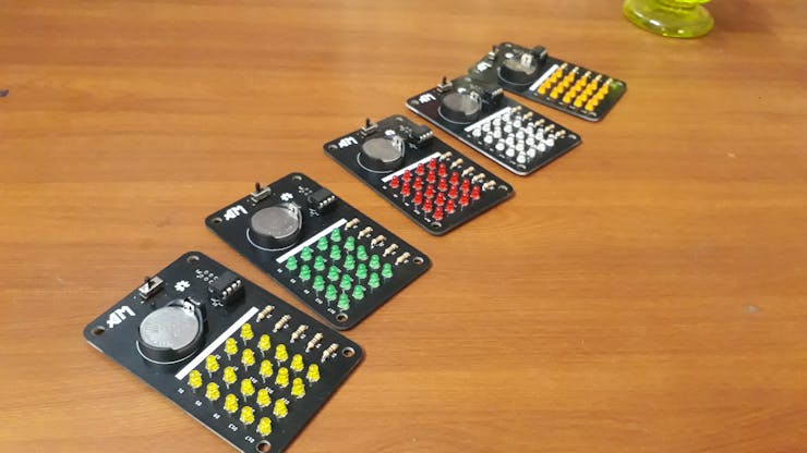

In this project, I will be showing how I built a badge-sized ATtiny85-based LED matrix display (5x4 matrix). I have used Charliplexing technique for driving 20 LEDs using ATtiny85.
you can even easily add extra texts to your badge as you wish.Standout from the crowd with this awesome PCB badge.

After soldering the PCB looks like this:
This project is open source. If you would like to build your own, all of the resources are available in the my GitHub page.

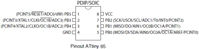

Step 7: Wire the Circuit to Flash ATtiny
(DON'T insert the battery now.)
On the PCB I have provided 6 pin connector for programming ATtiny85.the small dot near the 6-pin connector is the first pin (MISO), see the photos for alternative connections.
- Arduino +5V ---> VCC
- Arduino GND --->GND
- Arduino pin 10 --->RST
- Arduino pin 11 --->MOSI
- Arduino pin 12 --->MISO
- Arduino pin 13 --->SCK
